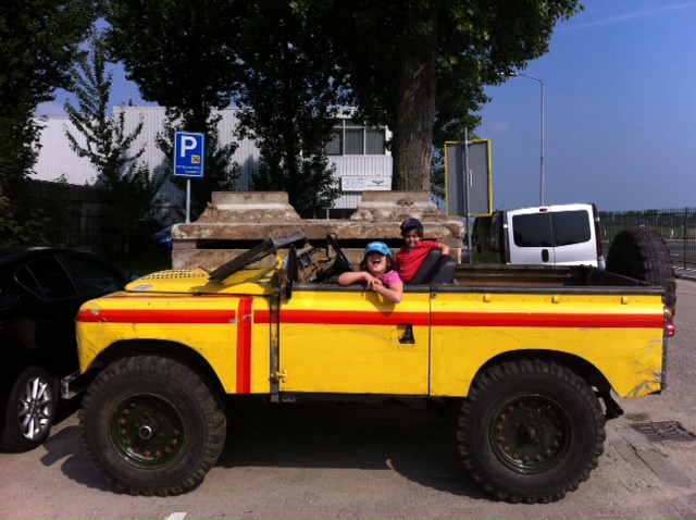

Not a LWT and these might not be 9.00s but this looks great. Subtleties to lift an S1 away from the now too predictable green lines of concours S1 you see at shows is a good thing. He's thought to shy away from one more sticker, and somehow it looks 'right'.
Along with the kinda' thing that's kept its 40-55 year old patina, this is a real LR.

Those are not 900x16s.
Do deep dish rims on normal Land-Rovers look cool? Yes they do. Sadly that fact alone has pushed the prices of them beyond the reach of many. 900x16 tyres though are not usually a good idea. They are expensive, have poor wear rates and are usually only available in a compromise pattern something equivalent to an all-terrain. Considering the massive range of good quality tyres available now in sizes like 235/85R16 I don't see why anyone would actually want 900x16s unless you have a 101, FC or 1-Ton and want to keep the "historic" appearance.

Wasn't sure what those were. Didn't look like 9.00s. However, the sad reality is, I am forced to agree with all of that. 9.00s can't be good. And I can't imagine you can be poor and go out to buy a decent S1 anymore either.
