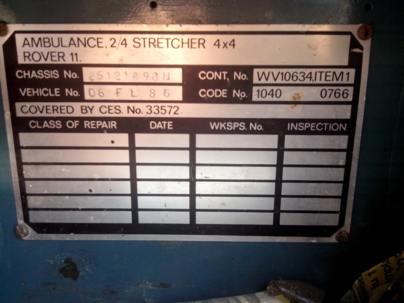

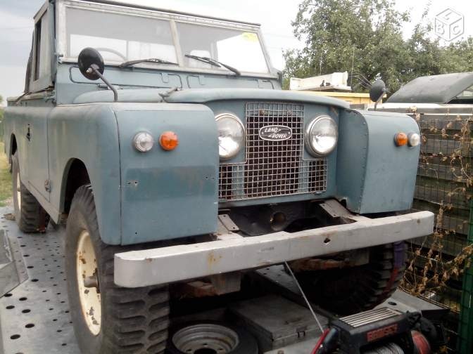

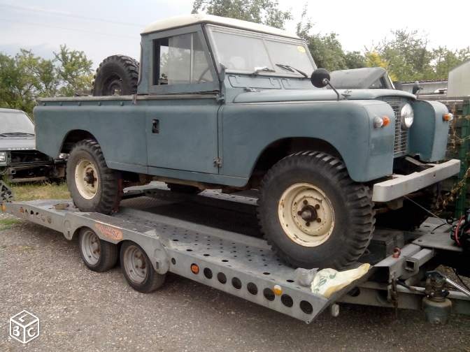

Hello,
I am in France and I found an interesting 109", but I need help to identify it.
It looks like a one ton, but the serial number indicates it is basic a 109".
However the chassis and wheel are typical from one ton.
Do you have any idea of the origin of this vehicle : ex-MOD ambulance, one ton prototype, ... ?
Thanks for your help,
Guillaume.
Re: ex-MOD or one ton prototyp ?
Postby 22900013A » Fri Oct 09, 2015 6:18 am
Ex military ambulance fitted with a truck body. Wheels and tyres bought in.
Jeremy
Posts: 241
Joined: Fri Oct 26, 2012 6:10 pm
Postby Jeremy » Fri Oct 09, 2015 6:35 pm
Has had wings and front changed as well. Looks like rackets for front anti roll bar is still there
