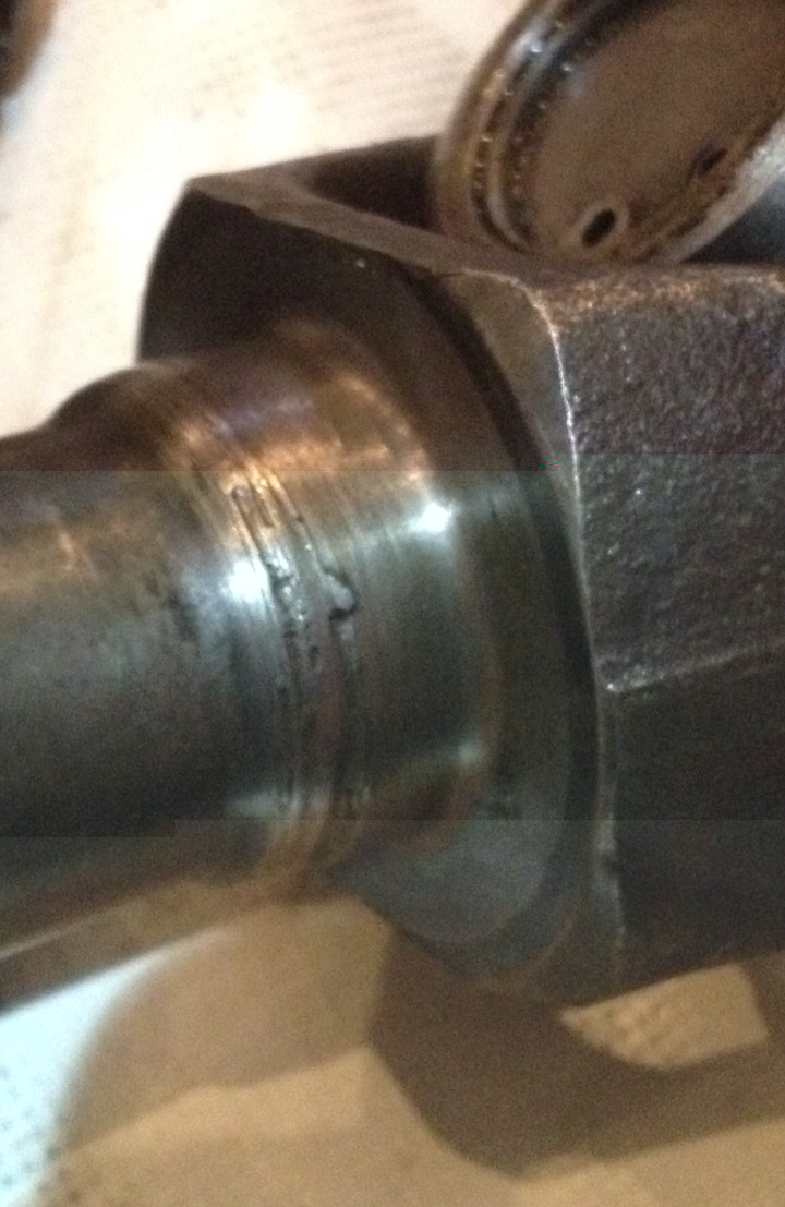

My first hurdle... Rebuilding the front axle on a resto project, the near side front half shaft has excessive wear on the stub shaft shoulder, note the beveled edges, the scoring on the shaft itself looks a lot worse in the picture
, I think this has been caused by missing spiralox ring in the drive member and distance piece so the half shaft has been able to move, any ideas on a source for these EVN unique parts?
Any advice welcome

Is it that much bigger than the standard series item?
Most things outboard of the swivels are the same as a standard series motor.
Worst case you could probably find a machine shop or similar to build up the damaged surface and turn it back down to size?

Sorry Das I haven't made myself clear, the main problem is sourcing the missing spiralox ring and distance piece. Am I right to assume they are going to be very difficult to find new?

I've just found the parts on lrdirect website

As you've discovered, same as a standard Series motor?
