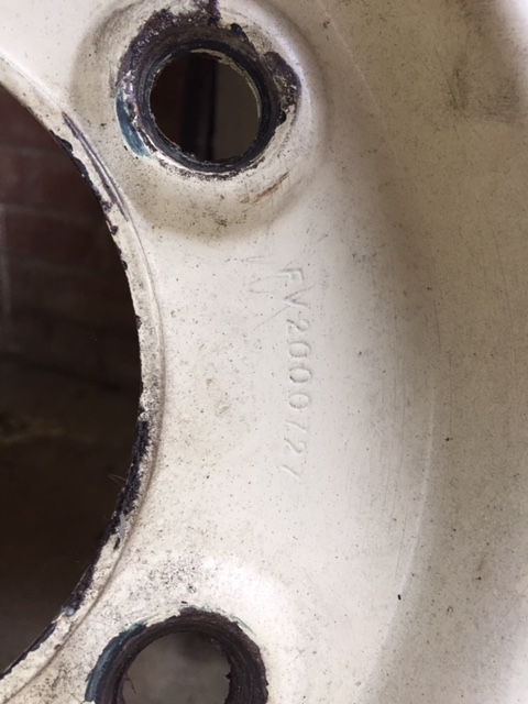

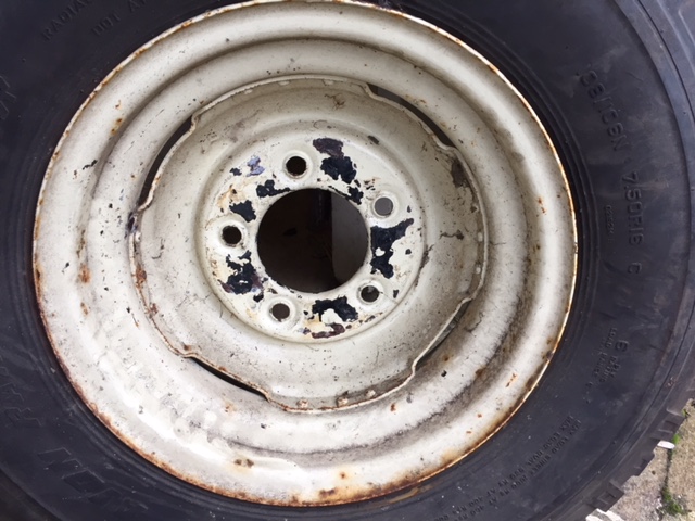

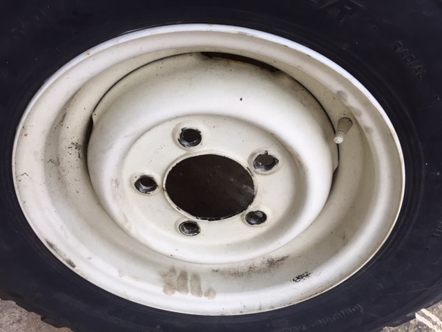

Here's some pics of my rims, do they look like they're for tubed tyres only?
Or do you require internal rim pics, if so I'll get some spoons out of the kitchen drawer and pull a tyre off!

They are riveted type, you can see them in the back shot.
