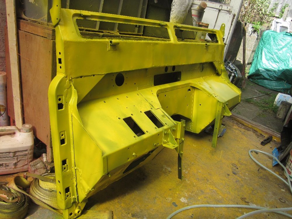

The cab is looking tidy, but is still missing the vital tranfer box levers and a heater(should it be a round or square one?)

Hi.
Looking at your heater mountings, I'd say a round heater.
Great build.
Taz
Posts: 1359
Re: CaptDicks IIB rebuild
Postby Wheeledbeast » Mon Dec 14, 2015 5:39 pm
Heater holes for smiths round heater pictured below... on a much less loverly paint job :cry:
